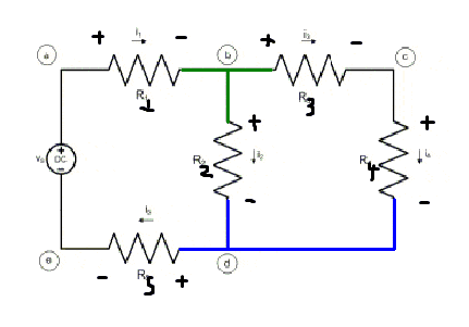

Where are the Nodes Located in a Circuit?

Suppose I set up the outer part of the circuit ( ie. everything excluding the R2 resistor)
Now If I want to set up the R2 resistor as shown, I need to know where the nodes b and d are located.
How do I locate node B for example? Is it the negative terminal of the R1 resistor or the positive terminal of the R3 resistor?
Nodes are the junctions where components connect. They are not identified with any component in particular. The entire contiguous conducting network associated with the junction comprises the node.
In the following diagram, the contiguous conductors in green comprise node b. The conductors shown in blue comprise node d.
Circuit schematic with a DC source on the left and resistors R1 through R5 with labelled currents I1, I2, I3, I4 and I5. Corners are labelled a, b, c, d and e; the green wire links b and the blue wire links d.
  • Circuit schematic with a DC source on the left and resistors R1 through R5 with labelled currents I1, I2, I3, I4 and I5. Corner nodes a, b, c, d and e are labelled, with the wire from b to d highlighted in green and the wire from d to c highlighted in blue.
