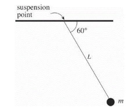

In the figure above, what is the torque about the pendulum’s suspension point produced
by the weight of the bob, given that the mass is 40 cm below the suspension point,
measured vertically, and m = 0.50 kg ? (let g = 10 ms^-2 for easier calculations)
Torque = force x perpendicular distance to the pivot

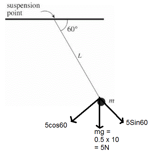

I first got the components of the Weight force:
And I got L using trigonometry:
sin60 = 0.4/L
L = 0.4/sin60
L = (4root3)/15 which is about 0.463
Now torque = F x Perpendicular distance =
5cos60 x L = 5cos60 x 0.463 = 1.15 N.m
But the answer is 2 N.m in the textbook! where have I gone wrong?
[/B]
I don't think you've gone wrong, I think the textbook has. It looks like they used the wrong angle or the wrong trig function for the calculation of the force component perpendicular to L. Your result looks okay to me.
