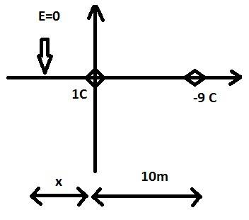

Here is an example.we want to calculate value of x where Electric filed going to be zero.i want to use vector form of coulomb equation
So as we know
for 1c:
for -9C:
so as we do superposition we obtain
So
In this problem x doesn't have any real number.what is my problem?
Any help appreciate
Why does your second equation have a -ax, but your third equation doesn't?
The electric field due to the two charges should be pointing in different directions at some position x to the left of the 1C charge. This condition is not met in the equation where you superimpose the fields.

Electric filed in equation 2 is in (-ax) direction but the third equation is in (+ax) direction it is because of charges positive or negative value.

In your coordinate system, the E field from the 1C charge at a distance x defined in the sketch is ##E_{1C} = - kq_1/x^2 \underline{e}_x ##. That of the -9C charge is ##E_{-9C} = kq_2/(10+x)^2 \underline{e}_x##. ##q_1, q_2## here are the magnitudes of the charges and their differing sign is manifest in the reversal of the unit vector.

Hi Baby_1 , your post #6 is correct. But the r vectors both go the same way, pointing to the left of both charges in the negative x direction.

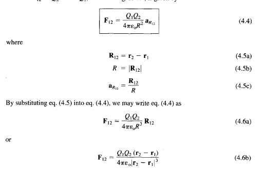

I found my problem.i wrote wrong the distance vector.here is an Electromagnetic book that explain better
here is the correct answer :

also I think you meant ##K\frac{9}{(x+10)^2}a\hat{x}##
Well done Baby_1!
