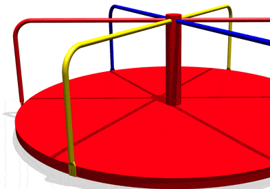

If you have a roundabout spinning with a man standing on it close to the centre, and then he walks out towards the edge of the roundabout, angular momentum is conserved, but kinetic energy is not (the roundabout rotates with a smaller angular speed). I'd like to know where the kinetic energy in this system goes to. Is the changed moment of inertia of the system some kind of equivalent to potential energy? As far as I know, ignoring all resistive forces, if the man returns to original position the kinetic energy will be as it was to start with. So surely energy is not being created or destroyed...surely there must be a constant total mechanical energy here, right?

Just to clarify, yes, where I'm from a roundabout is the object you described found in children's play parks, as well as a traffic device.
Carousels and merry-go-rounds are the things found at funfairs, where you sit on a horse or a spaceship and you go round daintily to the tune of music.
Right, the playground version of the roundabout is much simpler than the fairground versions with things to ride; they look something like this:
Or this:
[PLAIN]http://www.mclaysplay.com/images/wicksteed/uploads/images/products/spiro-whirl-48.jpg
Lots of dangerous fun!
See: http://en.wikipedia.org/wiki/Roundabout_(play )
