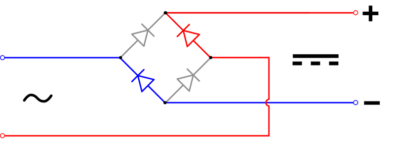

How have you made your diode bridge? Part Number/s ?

And I made bridge accordingly ,shown in the picture.

1.2 V IN Two diodes. I am at work now but they are fast diodes with 4 ns. And When I measure with oscilloscope , I am getting the same efficiency as in diodes. So I would say, diodes are almost lossless.
I believe you have just confirmed that you are using Schottky fast recovery diodes. That is good.
The 50% circuit efficiency is probably explained by the transformer impedance mismatch due to the wrong turns ratio of the two coils.
