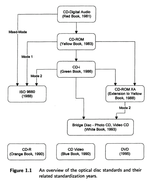

The Wikipedia is lacking on properly-developed resources, although it does have one great reference; as edited into original post, Sorin's The CD-ROM Drive has the in-depth discussion I was looking for. Additionally, Vanadium alerted me to the Red Book, which I was not aware of - it is mentioned in Sorin, shown in the attached flow chart from pg.6.
