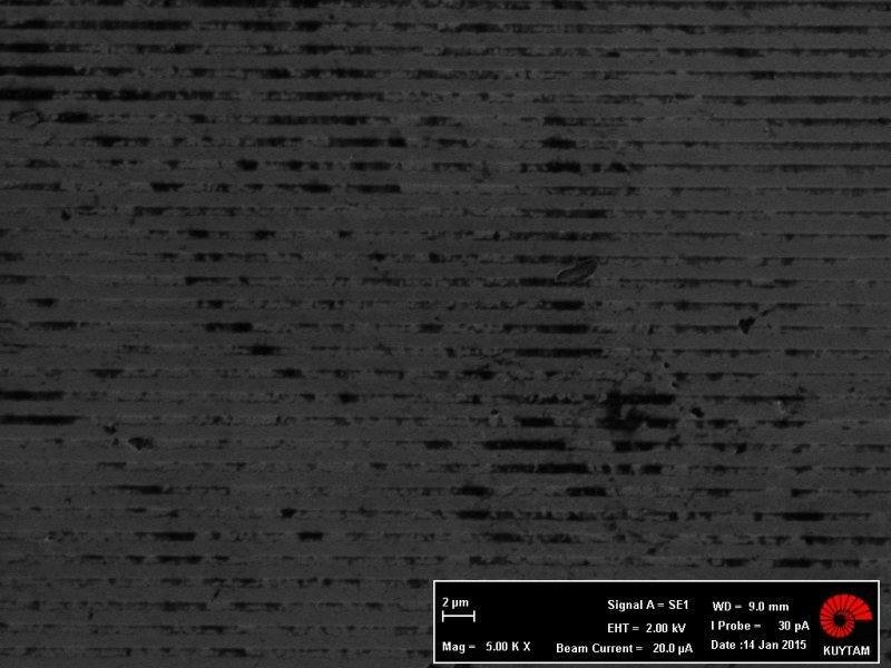

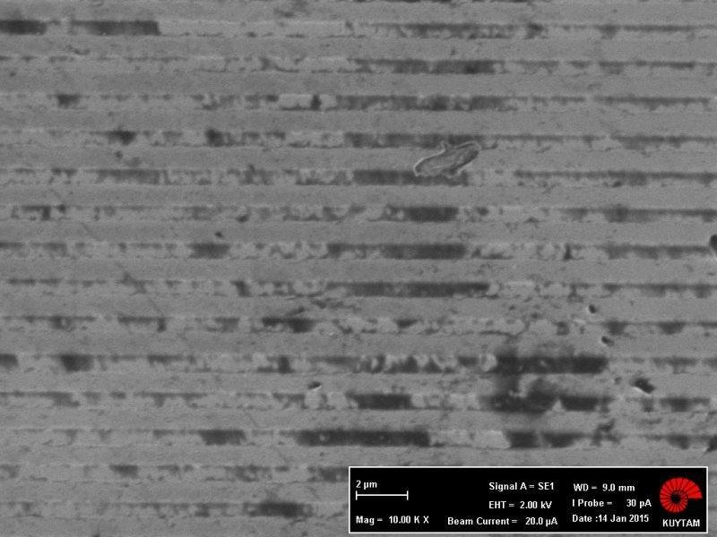

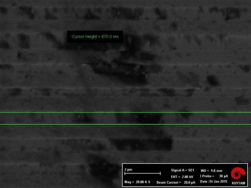

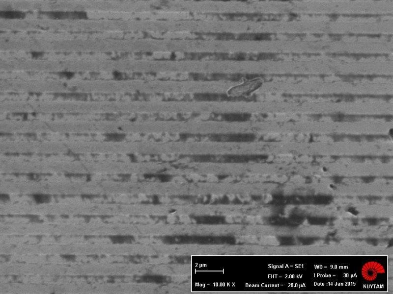

Actually I got the following images where the track pitch is nearly the half of the value indicated on the web and your post (0.8μm ). In order to image the CD-R(Not a CD-ROM), first I broke it carefully then I proceed with the aluminium layer just under the label which did not give much of an image and later I decided give the polycarbonate surface a go and got the resulting images at different magnifications.

You have any idea why the track pitch was half of the value it should be?
