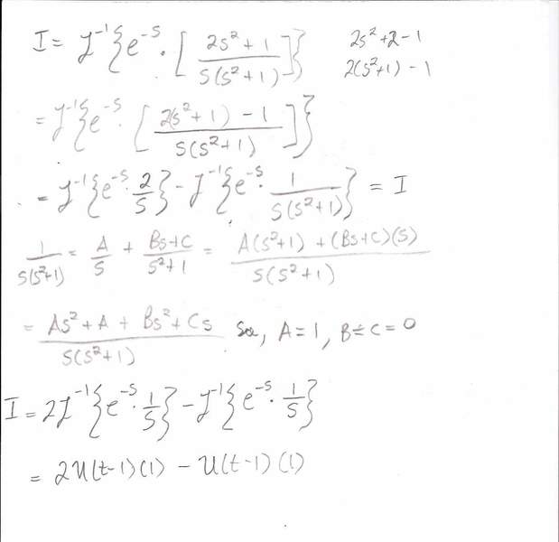

Find the inverse laplace transform. (see figure attached for question as well as my attempt)
I came up with a different answer than the given solution, and I can't figure out where I went wrong.
We are given a table of common Laplace transforms and can refer to them without proof.
I've got a feeling I made a mistake just because of how my partial fractions decomposition came out, it just doesn't make any sense.
Thanks again!
EDIT: I found my mistake in my partial fractions decomposition. A+B = 0, B = -1, C=0
  • Handwritten derivation of an inverse Laplace transform, with partial fraction decomposition of (2s^2+1)/(s(s^2+1)) and the result 2u(t-1) - u(t-1)(1) shown at the bottom.

Your partial fractions are wrong. You said [itex]A=1, B=C=0[/itex], but plugging those values in, you get,
[tex]\frac{1}{s(s^2+1)} = \frac{A}{s} + \frac{Bs+C}{s^2+1} = \frac{1}{s}[/tex],
which isn't quite true.
Edit: Sorry, I didn't see your edit :).
