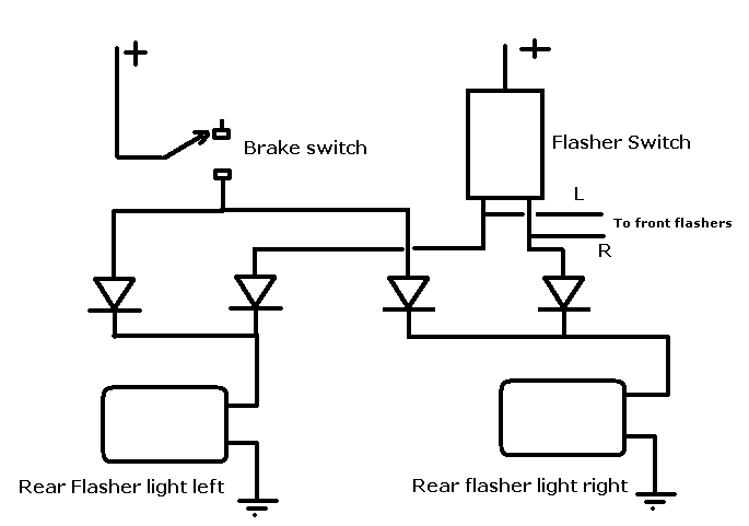

I am adding a function to the rear Turn Signals on my motorcycle (12vDC negative ground system). Turn Signals have 1157 incandescent bulbs - they have two filaments and three wires: ground, hot to running light, and hot to flasher.
I want my Turn Signals to ALSO act as Brake Lights. So all I have to do is add a wire from the Brake Light to the hot flasher wire of my Turn Signal.
Except, of course, that there are two Turn Signals. So if I connect wires to both, my Turn Signals will no longer operate independently (because they are both connected to the Brake Light).
So I figure a Diode will prevent current from one Turn Signal passing across the brake light to the other Turn Signal. Of course, I will need two diodes - one on each Turn Signal.

If this was possible, you would need two diodes for each lamp. One coming from the brake switch and one from the flasher switch.
An easy way of doing this would be to get two 30 amp bridge rectifiers and only use two of the four diodes in each one.

Thanks to you, I THINK I have a diagram that will work.
I have seen posts on this website with wiring diagrams - how do I do that ?
Then I could post what I think will work and you could check it.
In words: four 5 amp diodes, one each on wires from brake switch to each turn signal, and one each on wires from flasher relay to each turn signal.
Thus the current arriving at the bulb (from either source) could not back track to either the brake switch or flasher relay.
These bulbs only draw 28 watts (less than 2.5 amps) so shouldn't a 5 amp diode be enough?
(There is very little room to add electrics inside motorcycles.)
See attached diagram.
Something like that would probably be OK. There will be a slight dimming of the rear flasher lights, though.

DrAlloway said:
...It seems that many years ago the auto industry wired cars under the mistaken believe that electrons move from Positive to Negative. So they designed cars as Negative Ground Systems.
Of course, we now know that electrons really flow from Negative to Positive - however - the auto industry never changed their system, because it works. Motorcycles are the same.
Just any FYI, positive ground systems were the norm long before negative ground. Any 6 volt system I've ever dealt with used positive ground. Some 12 volt systems even used positive ground for a while after the switch. Most of the time electronics are designed with the negative being the 'common' or 'ground' whichever terminology you prefer to use and it certainly isn't because they didn't know which way the current flows.
The front flasher lights would be unaffected.
Excellent - our diagrams are topologically the same although mine sure doesn't look as good as yours.

The reverse voltage rating of a diode does not change its forward voltage drop. This is pretty standard for silicon diodes.
Don't forget, though, that these diodes will get hot. They will be dissipating 2-3 watts each.
I suggested using bridge rectifiers. These come in a square block about an inch square and they can be mounted on metal to get rid of heat. You would need two of them.
Don't worry about electron flow. Diodes conduct if their anode is more positive than their cathode.

If I understand your wiring diagram correctly - the diodes will only conduct current when the light is either flashing or braking. Both are short lived events. So I am just going to ignore the heat dissipated.
I have found (so far) 3 diodes that meet my basic specs of 3+ amps and 15+ volts.
However, I have no idea what the differences between them are:
Schottkey diode
10 amp, 100 PIV for 85cents each
Rectifier diode
6 amp, 200 volts at 90cents for two
High-Voltage UltraFast Rectifier
15A, 600V to 200AC at 1 dollar each
As a shot in the dark - I would go with the Schottkey.
Will that work??
I would really prefer which ever diode is the smallest as there is very little room for installation.
Any of those diodes would probably be OK.
I like Schottky diodes so I'd probably use those, but they would be a bit of overkill.
You might get a lower voltage drop with Schottkys, which would be good.
Diodes have very small mass and can overheat rapidly. They can be destroyed like that, so it is worth considering how hot they will get. If they get too hot to touch, they are probably at risk of destruction.
Diode size influences heat dissipation so small diodes will get hotter for the same power dissipation.

I assume when a diode dies, that it won't conduct current in either direction ??
These diodes will be located under my passenger seat with lots of other wires and connectors. I would typically wrap them heavily with electricians tape for insulation. However, with the heat dissipation issue, perhaps I should wrap just the leads and leave the diode itself exposed to whatever air is circulating?? ((this assumes, of course, that the diode's exterior shell is non-conducting??))
I found a Schottkey diode for 85 cents that is Dual packaged
It is 10 amps, 100 volts.
It has 3 leads: 2 IN and 1 OUT
I assume that means 10amp diode on EACH lead IN??
This will make wiring easier and smaller (I think).
As only 1 diode would be working at any given time, this could help heat dissipation ??
Well, here my lack of EE education raises an interesting question.
When the Flasher is ON it will allow current into the Bulb - let's call it 2 amps for simplicity.
When the Brake is ON it will allow current into the Bulb - it would also be 2 amps because that is what the 1157 bulb will draw. So only one diode will be dissipating heat at once.
However, what if the Brake is ON while the Flasher is ON?? I assume the 1157 bulb will only draw 2 amps no matter how much current is available?? So 1 amp will come from each?? The Brake (being constant) will fulfill all the bulb's current draw, so the Flasher will not send any more current to the bulb? What would actually happen??
Diodes usually fail in the shorted condition. Maybe it depends on what caused the failure.
Either way, it is bad news and you don't want it to happen.
You could use those dual package Schottkys if they have two anodes and a common cathode.
They are probably like the ones in PC power supplies and are intended to mount on a heatsink.
They would look like a small power transistor.
If Silicon diodes are in parallel, the one with the lowest turn-on voltage will conduct first. At heavier currents, the voltage across the conducting diode will increase and eventually the other diode will start conducting. Schottkys however, don't have such a sharp turn-on voltage as normal Silicon diodes, so I'd guess they would tend to share the load.
Either way, the lamps would still only get their normal current or a little bit less.
I would never wrap up a diode in anything unless it was drawing a trivial current. It makes a big difference to the heat dissipation.
Yeah, they have a metal tab with a mounting hole.
So my plan is to attach the wire from the Flasher Relay to one anode and the wire from the Brake Switch to the other anode. Then simply run the wire from the Bulb to the common cathode.
They are 10 amp diodes (in a dual package) and I will only be running 2.5 amps through each one and only when my Turn Signals are Flashing or Braking - so I am expecting they won't overheat.
You have been a great help - so thanks a lot.
I will order parts this weekend and let you know when they get installed.
