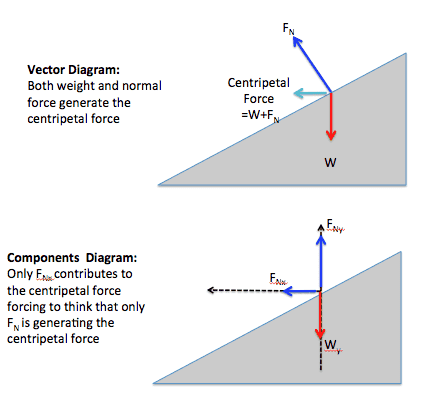

This is what I was trying to explain:
Two force diagrams on a sloped incline: the top shows weight W and normal force FN with resultant centripetal force W+FN pointing left; the bottom resolves FN into horizontal FNx and vertical FNy, with Wy shown downward.
For a banked curve, your components diagram should show the apparent weight of the car normal to the track surface, not vertical. The components should sum to zero. The track "feels" the weight of the turning car as the opposite of the vector sum of the vertical and horizontal components depicted.
In a free body diagram there is no apparent weight. The only two forces are W and F_N which have their x and y components.
Let's back up here a second... The centripetal force is not caused by the angle of the track -- a straight track could have a similar slope, but it would not cause the car to travel in a circular path (although the driver would have to fight gravity trying to pull him down the slope, that would not be a centripetal force). The centripetal force here is the result of the curved track continuously changing the direction of travel. The centripetal force manifests itself in the continuously changing velocity vector as the car circles the track (if the circular track were flat, the lateral friction of the tires would have to provide the direction change in place of the slope of the track).

I guess my point is: what force(s) determine the centripetal acceleration? Both W and F_N or only F_N? According to the vector diagram both forces but according to the component diagram only F_N

I think the vector equation is what represents best the physical aspect of the problem. In the sense that both forces are needed to provide the centripetal force in the sense that the normal force is also dependent on Weight.
The component diagram can make things look different. Sometimes the choice of a certain coordinate system completely can make equal to zero the components of a vector...

I wouldn't concentrate on physical aspects here, because the issue is purely mathematical about how vectors work.

The centripetal net force is simply the vector sum of both forces, so it obviously is affected by both. The dependency between them is completely irrelevant to this.

Two orthogonal vectors will stay orthogonal, no matter how you rotate your system. They will never have a component parallel the other.
