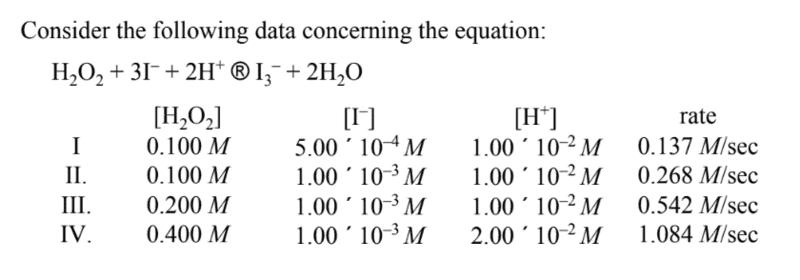

Oh, I believe it might be this data that they're referring to...
  • Table of rate data for H2O2 + 3I- + 2H+ giving I3- + 2H2O: four runs listing [H2O2], [I-], [H+] in M and rate in M/sec, with rates 0.137, 0.268, 0.542 and 1.084 M/sec.

Compare I and II. What is the effect on the rate of doubling [I-] while keeping everything else constant? So how does the rate depend on [I-]?
Compare II and III. What is the effect of doubling [H2O2]?
Compare III and IV. Here you double both [H2O2] and [H+]. But you have already determined the effect of doubling [H2O2]. So what is the effect of doubling [H+]?
Now you know the dependence of the rate on the 3 concentrations, what does that tell you about the rate-determining step?
@mjc123
So from your questions, I can get the rate law, which would be something like
Rate = k*[H_2O_2]*[I^-], and we can plug in any row's data to find k.
