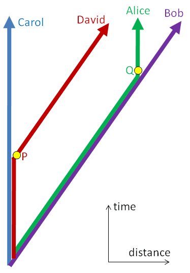

To illustrate what kev just said, consider this "quadruplets paradox".
Alice and Bob set out from Earth at 0.9c. Carol and David stay on Earth.
After 9 years 8 months have passed on Earth, David follows out on the same route and speed as Alice and Bob. Carol remains on Earth.
Meanwhile, after 9 years 8 months have passed on Alice and Bob's ship, they reach their destination (20 light years from Earth). Alice jumps off ship, decelerates and stops (relative to Earth), but Bob continues at 0.9c away from Earth.
David is at rest relative to Bob. When they compare their ages by exchanging messages and allowing for the delay, they find that, at the moment P that David left Earth he had aged 9 years 8 months since the experiment began but Bob had aged 22 years 3 months.
Alice is at rest relative to Carol. When they compare their ages by exchanging messages and allowing for the delay, they find that, at the moment Q that Alice arrived at the planet she had aged 9 years 8 months since the experiment began but Carol had aged 22 years 3 months.
To summarise, Alice and Carol agree that Carol is older, and David and Bob agree that Bob is older. But, until they separated, Alice and Bob traveled together and so were the same age; until they separated, Carol and David traveled together and so were the same age.
According to David & Bob, immediately after David left Earth (P), Carol = David < Bob.
According to Alice & Carol, immediately after Alice landed on the planet (Q), Bob = Alice < Carol.
So everyone disagrees over whether Bob or Carol is the oldest.
Complications like this are the reason why the twins paradox is formulated in terms of twins who meet each other again so that there can be no disagreement over who is older.
