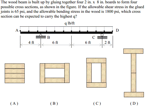

Which wood cross sectioπ caπ carry hïghest uπiform load
Moment of inertia for rectangle I=(1/12)bh3
τ=(VQ)/(I*b)
σ=(MV)/I
I started by finding reactions at B and C
Then drew the sheer and moment diagrams (to save space i made it a link)
http://oi47.tinypic.com/qsmkxh.jpg
To find which cross section can withstand the biggest q, I found the moment of inertia about the z axis (neutral axis) for each figure.
(A)Iz=2*{((1/12)*8*23)+[(2*8)*32]}+2*{((1/12)*8*23)+[(2*8)*12]}
Iz=341.33 in4
(B)Iz=2*{((1/12)*8*23)+[(2*8)*32]}+2*{((1/12)*2*83)}
Iz=469.33 in4
(C)Iz=2*{((1/12)*8*23)+[(2*8)*52]}+2*{((1/12)*2*83)}
Iz=981.33 in4
(D)Iz=2*{((1/12)*8*23)+[(2*8)*92]}+2*{((1/12)*2*83)+[(2*8)*42]}
Iz=3285.33 in4
Because both of the equations I posted for τ and σ are dependent on Inertia, I figured since that when solving for (q) we would have to multiply by Inertia so whichever cross section has the biggest Inertia will also have a bigger (q). Therefore, cross section (D) was the pick. Was I right to assume this?
τmax=[(6.5q)*Q(0)]/[3285.33*2]=65; where Q(0)=208. not sure about that value
∴q=315 lb/ft
σmax=[(34.125lb-ft)(12in/ft)q*10]/3285.33=1800
∴q=1444.10 lb/ft and so the max q can be is 315 lb/ft
This is my first attempt so any help is appreciated.

Blugga: Is this a take-home test question? I currently cannot match your x1 = 10.5, on your shear diagram, yet. Are you sure x1 is correct? Try again. Therefore, I cannot match your bending stress equation yet.
Your shear stress equation looks fine. Your moments of inertia look fine. How will you know which cross section can carry the highest q if you do not check them? You will just guess?
No, I do not think so.
It's a sort of take home quiz. The book doesn't go into depth into how to find this sort of info for these shapes. It just explains briefly for 1 or 2 wood boards, and i have 4.
I think you may be right about the X1 being off. I think x1 will just be 10.5ft - 4ft. So x1=6.5ft.
Therefore, Mmax=13.125q.
Also, i guess my reasoning was that from the bending stress alone cross section (D) would be greatest. But i didn't count that the glued joints would make all the difference. I did try to find qmax for each cross section (but with the wrong Mmax) and ended up with cross section (C) carrying the highest q. I'll rework the new figures in the morning. Thanks for the help.
