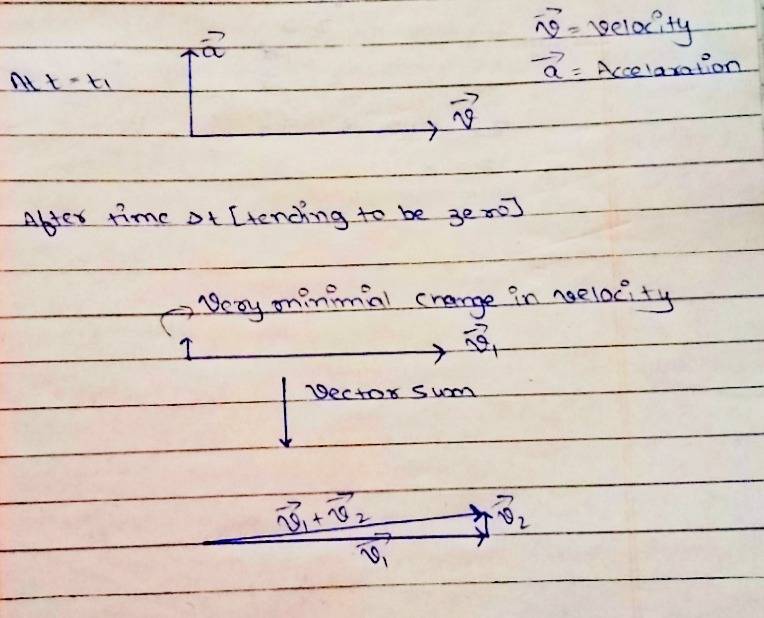

As I have shown in the picture even if their is minimal change but shouldn't it increase after a long time as minimal changes will keep accumulating.

Sir force is applied continuously perpendicular to the velocity as in case we rotates a stone using string and sorry I missed showing the force in my picture.
In force diagram you drew, you allow the acceleration vector to be no longer perpendicular to the instantenouos velocity for the entire period Δt when it acts along the direction of the V2 vector, apart from the very first moment t1. It doesn't matter how short you make that period - the acceleration is not perpendicular to V1 at any time apart from the first instant.
For a change in direction only (as with e.g. circular motion) the acceleration vector must remain perpendicular to velocity at all times.

As @Bandersnatch notes, the problem is that you are allowing your velocity vector to change in your small time interval, but not the acceleration vector. If there's enough time for the velocity vector to change (possibly only infinitesimally) then there's enough time for the acceleration vector to change (possibly only infinitesimally). So the total acceleration in your ##\Delta t## won't be purely vertical, but will have a leftward component which will lead to it satisfying ##|\vec v_1+\vec v_2|=|\vec v_1|## (in the limit as ##\Delta t## goes to zero, anyway).

Let ##K = \frac 1 2 m v^2 = \frac 1 2 m \vec{v} \cdot \vec{v}## be the kinetic energy of a particle. $$\frac{dK}{dt} = \frac 1 2 m \frac{d}{dt}(\vec{v} \cdot \vec{v}) = m (\frac{d\vec{v}}{dt} \cdot \vec{v}) = m\vec{a} \cdot \vec v = \vec F \cdot \vec v$$
Hence, if the force is perpendicular to the velocity, then ##\frac{dK}{dt} = 0##, which means the kinetic energy of the particle is constant, hence the speed is constant.

Not at all. $$\vec F \cdot \vec v = 0 \ \Rightarrow \frac{dK}{dt} = 0 \ \Rightarrow \frac{dv}{dt} = 0$$
PS Note that in post #11 I showed that: $$\frac{dK}{dt} = \vec F \cdot \vec v$$

Whenever I see students with this misconception, they always look at the situation evolving forward in time. That is, they look at the velocity vector now, apply the [assumed to be] constant acceleration and derive that the velocity vector later has increased in magnitude. From this they conclude that speed must be increasing.
None of them ever bother to do the same calculation going backward in time to determine the velocity a moment ago. If they did, they would see that the speed a moment ago must also have been higher. So the same [mistaken] argument proves with equal force both that speed is increasing and that it is decreasing.
Edit: Of course, that's the difference between a parabolic path and a circular path. For a parabolic path (constant acceleration), the speed really does increase both forward and backward in time. For a circular path (always perpendicular acceleration) the speed stays the same both ways.

To decrease velocity magnitude, you need an acceleration component anti-parallel to velocity.
To increase velocity magnitude, you need an acceleration component parallel to velocity.
If the acceleration has neither component, then velocity magnitude cannot change.

The SUVAT equations work equally well in predicting how a system behaves going forward in time and going backward in time. You can trace the trajectory of a stone on string or a planet in its orbit into the future or into the past.
You have presented a calculation which purports to show velocity increasing into the future. How about applying that calculation to see how velocity behaves going into the past?
The laws of classical Newtonian physics are invariant under time reversal. If you can take a symmetric situation and derive an asymmetry, you've goofed.
