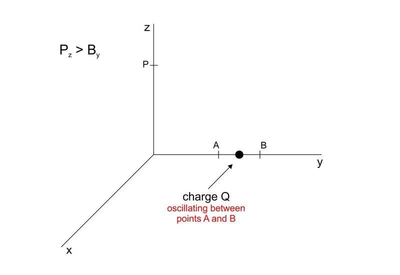

Just to check a point: if the point charge Q oscillates sinusoidally between points A and B, on the y-axis, one is to observe a radiation field at point P located at z-axis (with the z component of point P larger than the y component of point B).
Is it correct?
OBS: the restriction in the parenthesis is to make sense when the point charge is part of the pulsating sphere.
Best wishes.
