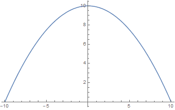

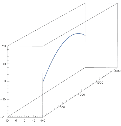

The inclusion of time as a third dimension (2 + 1) in situations like the one shown below lead to the clearification of the notion of curvature of spacetime. I have ploted the time axis using c = 100 just to give an idea.
Plot of a downward-opening parabola-like curve against x from -10 to 10, peaking near 10 at x = 0 and reaching zero at both ends; y-axis labelled 2, 4, 6, 8, 10.
3D plot with a blue curve rising from near zero at the left, peaking around x = 1000 and falling toward x = 1500, on axes labelled 0 to 2000 (horizontal), -20 to 20 (vertical), and -10 to 10 (depth).
Regarding the graphics of cartesian and polar coordinates, with good humor but also very respectfully, I must say that is an invitation to a trap by A.T. :smile::smile:. I mean something that could well be represented by the schemes of these two coordinate systems. But the important difference is in the fact that in each system, the principal lines are to be understood as the trajectories a massive body would follow as a manifestation of Newton's first law.
Chapter 1 of MTW has a similar discussion (see in particular Box 1.6).
