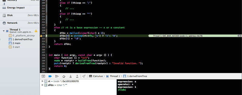

Why am I getting EXC_BAD_ACCESS here?

Screenshot:
Xcode debugger screenshot showing C source lines 219 to 233 with a line highlighted, where a strcmp call on rt->fx is marked with a Thread 1 EXC_BAD_ACCESS error, and the variables panel shows rt and dfdx.
Here's a full code dump if you think the issue could depend on a line not shown in the screenshot: http://codepad.org/zSE1vobz
strcmp compares two strings. You don't show enough code so that I can determine what rt->fx represents, but 'x' is a character constant. Since both args of strcmp are strings (i.e., of type char * or char []), strcmp attempts to access the characters that are pointed to by its two arguments. Passing in 'x' (which happens to have an ASCII code of 0x78) causes strcmp to attempt to access the byte at memory location 0x78. This causes the access error that you are seeing.
All of the string processing functions that are declared in string.h take pointers for their string arguments.

Thanks!
I knew that strcmp compares 2 strings ... I'm just an idiot who put 'x' instead of "x".
