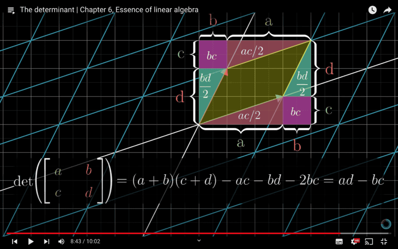

I'd like to have a little insight about why the determinants of ℝ2x2 and ℝ3x3 matrices are computed that way.
I know how to calculate said determinants in both the cases and I also know what's the meaning behind it thanks to "3blue1brown"'s youtube channel, which states that they are a scaling factor respectively to the area of a surface in ℝ2 and of a volume of a parallelepiped in ℝ3, but what's the connection between, as in the simpler case, the scaling factor of an area in ℝ2 and it being computed as ab - cd ? (Say the matrix is [a c; b d] meaning "a c" is the first row).
What's the geometric intuition or derivation?

So, I found my answer. My bad for posting this thread without double checking or continuing said youtube series on the essence of linear algebra.
I don't know how to behave in this case, should I keep the thread or should I (or who has the power) delete it?
In the meanwhile, I'm going to attach an image which answers my question in the ℝ2x2's matrices cases.
The ℝ3x3's and general non square matrices remains to be answered, though.

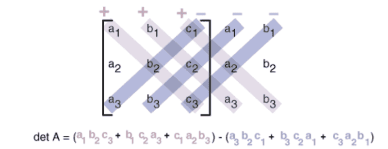

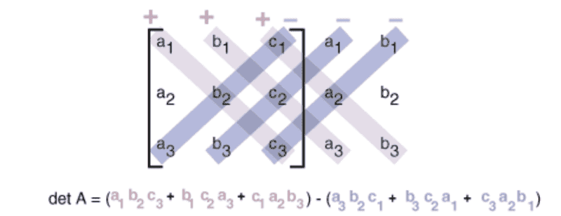

The definition of a determinant is the sum of the signed elementary products (which you can look up if you never heard this before.
For a 2x2 the ab-cd method evaluates by the definition:
For a 3x3, this "shortcut" evaluates the determinant by definition:
Geometric interpretations are the consequence of the definition, not the other way.
