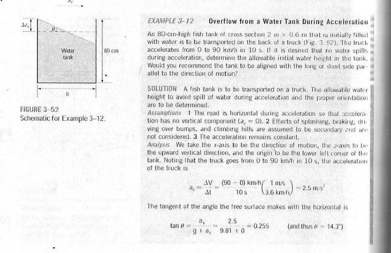

in the second picturre, why the zs1 and zs2 is calculated by using 2m and 0.6m respectively ? it should be 0.8m , am i right ? what's the purpose of the author to use 2m and 0.6m ?
  • Textbook page showing Example 3-12, Overflow from a Water Tank During Acceleration, with a solution worked out in printed text and equations; the schematic (Figure 3-52) shows an 80 cm high tank partly filled with water, with the free surface tilted and labelled b for the tank length.

0.8m is the height of the tank. The author is comparing two orientations of the tank. In one orientation the front-to-back distance is 2m, in the other it is 0.6m. The zs values are the corresponding extra heights of the water, so one calculation uses 2m, while the other uses 0.6m.

can you please sketch out the 3d diagram , so that i can understand better
