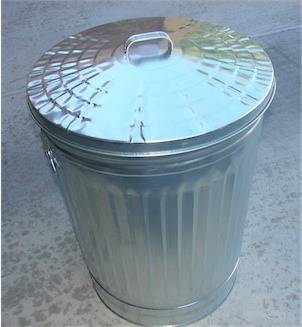

Want to protect your toys from an EMP? Put them inside a metal trash can with newspaper insulation on the bottom and sides so nothing touches inside with the lid sealed with metallic tape.
