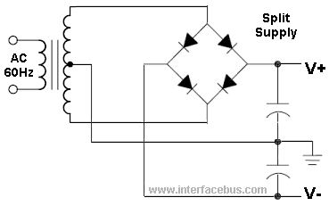

Or you could get a "split supply" out of it:
Something wonky with the diode orientations, methinks. I see direct paths through the diode shorting the secondary.
You're right - Good Eye !
They swapped the AC and DC terminals of the bridge.
Should be Plus at the bottom. Minus at the top, and AC into the sides.Going back to your OP's own sketch and making it split supply,
Simplify your thinking
When looking at a full wave bridge rectifier for a power supply circuit...
DC side always faces two anodes or two cathodes (or three for three phase)
AC side always faces one of each
Someday you'll run across a "Ring Modulator" that violates the rule , but it's for a signal not a power supply circuit.
Thanks. Yup, over the (many) years I find I've become somewhat adept at spotting these little slip-ups in "pulp-published" circuits.
I just wanted to make sure that some newby didn't try to build the circuit as shown. Fried components can be quite discouraging.
