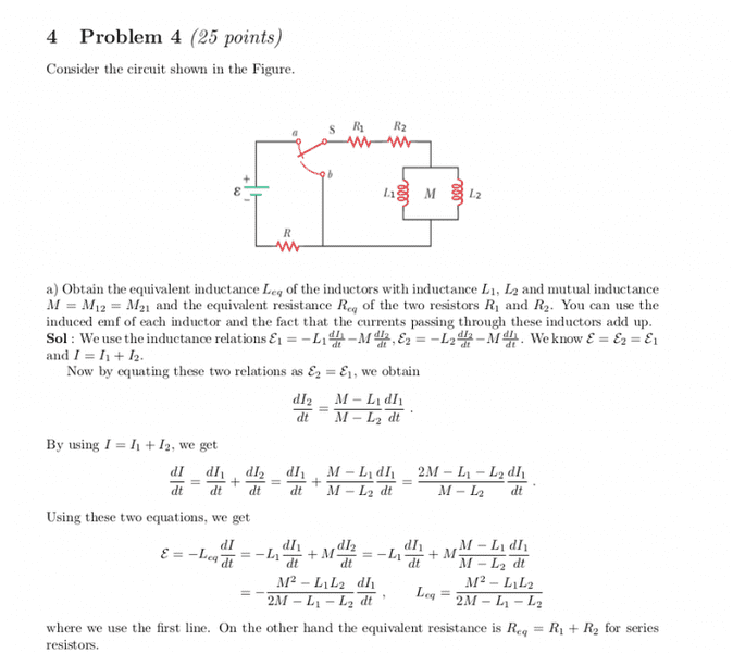

Given two inductors, connected in parallel connected to a battery, why do the following emf relations hold?
$$\mathcal{E}_1 = - N_2 A \frac{d B}{d t} = -M\frac{d I_1}{d t } \\
\mathcal{E}_2 = -L_2 \frac{dI_2}{dt}- M \frac{dI_1}{dt}$$
See attachment !
[/B]
I know for example that the mutual inductance on coil 2 caused by the change in current I_1 is
$$\mathcal{E}_2 = - N_2 A \frac{d B}{d t} = -M\frac{d I_1}{d t },$$
It's not clear to me how there are two terms of the rhs of each of the equations in part (1) !

Mutual inductance ## M ## is defined as ## M=\Phi_{1,2}/I_2=\Phi_{2,1}/I_1 ## (the inductance is mutual, i.e. ## M_{1,2}=M_{2,1}=M ##), where ## \Phi_{x,y} ## is the magnetic flux in x due to y. You can then write ## \varepsilon_{1m}=-d \Phi_{1,2}/dt=-M d I_2/dt ## for the effect of change in current in inductor 2 on inductor 1, but you also need to include the self inductance: ## L_1=\Phi_{1,1}/I_1 ## to get another source of EMF in inductor 1: ## \varepsilon_{1s}=-d\Phi_{1,1}/dt=-L_1 dI_1/dt ## . ## \varepsilon_1=\varepsilon_{1m}+\varepsilon_{1s} ##. ... Similarly for inductor 2.
