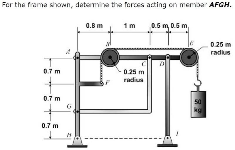

Why are there two values of Hy here?
  • Thread starter Thread starter edsoneicc
1 reply · 1K views · last reply
edsoneicc
∑M at H = 0 and ∑M at I = 0
∑Fy = 0
Assuming that Iy is positive and Ix is negative; Hy is negative and Hx is positive.
Now I would like to compute for Iy and Hy using
∑M at H = 0 = Iy(2.3) - 50(3.05)
Iy = 66.3043
∑Fy = 0 = -50 + 66.3043 - Hy = 0
Hy = 16.3043
But if I use
∑M at I = 0 = Hy(2.3) - 50(3.05)
Hy = 66.3043
Why do I have different values for Hy?Also, is DI a two force member?
But if I use
Are you sure about that 3.05 distance?
