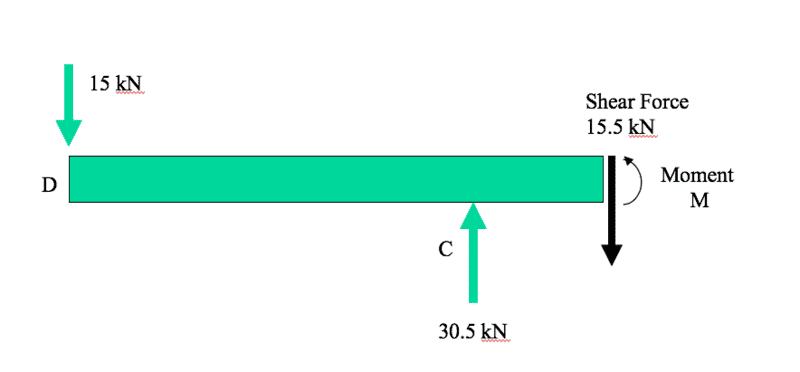

Have you drawn a free body diagram of the portion of the beam between the cut and either one of the ends? What shear force and moment would you need to apply at the cut to hold that portion of the beam in equilibrium?

I don't confirm your reaction forces. I get a reaction force of 30.5kN at C and a reaction force of 4.5kN at A. These add up to 35 kN, and balance the moments about points C and A. You seem to be using 37.5 kN at D, while the figure shows 15 kN.

I don't get what you did. For the shear force 1 m to the right of point C, I get a downward shear force on the right-hand frame of the left-hand section of 30.5-15 = 15.5 kN. If M is the counterclockwise moment on the right-hand face of the left-hand section, taking moments on the left-hand section about point C, I get $$15(2.5)+M-15.5(1)=0$$So M = -22.0 kN.m
Or taking moments about the point 1 m to the right of point C, I get $$15(3.5)+M-30.5 (1)=0$$
So, M = -22.0 kN.m.
Or, taking moments about point D, I get $$30.5(2.5)+M-15.5 (3.5) = 0$$
So, M = -22.0 kN.m

You are not drawing your free body diagrams correctly. As Chestermiller has noted , when you want to find the internal forces and moments at a certain point along the beam, you cut the beam at that point away from the whole beam, then analyze that cut portion separately using the equilibrium equations. There is an unknown shear force and moment at that cut. Solve for them as instructed. You can use either the left cut part of the beam, or the right part of the beam. Not both!

Chestermiller said:
Hi!
Thanks for your reply. That explained a lot, and I think that that I got it now. Then only part 2 remain.
