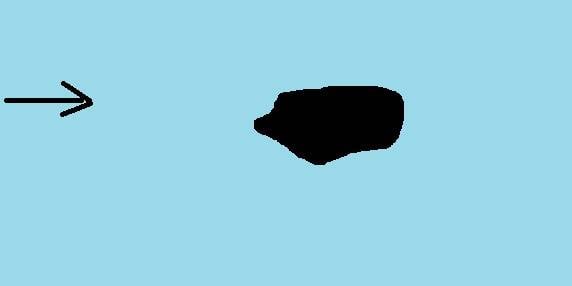

What if I have object in flow where shape is not symetric and different pressures at each point ,how than I integrate total force?
It is just vector calculus; with a pressure ##p = -\rho g z##, defined up to addition of an arbitrary constant (##p' = p + a \implies \nabla p = \nabla p'##) the surface force is$$\mathbf{F} = -\oint_{\partial \Omega} p \, d\mathbf{S} = -\int_{\Omega} \nabla p \, d\tau = \rho g \mathbf{z} \int_{\Omega} d\tau = \rho g V \mathbf{z}$$where ##\rho## is here the fluid density, and ##\mathbf{z}## a unit vector pointing vertically upward [this assuming constant density of fluid!].
There is also a heuristic 'physicsy' explanation. Imagine that you replace the body with a parcel of fluid of the same shape; it is clear that this parcel of fluid must be in equilibrium, and since its weight is ##-\rho g V \mathbf{z}##, the buoyant force (the total force due to the surface pressure forces, which depends on the shape of the boundary) must equal ##\rho g V \mathbf{z}##.
For your original post the there is indeed no net side force. For the picture you are showing here (rocky thing in free stream?) the side force is not necessarily zero.
Integrating the force over an object is obviously just computing this integral (cartesian coordinates):
F_i = \oint_{\Omega} \left(p n_i + \tau_i\right) dS
Which is a contour integral around the whole surface area where ##\Omega## is the boundary of the volume (i.e. its surface, in 2D a line), ##i## refers to the component of the resultant force (##x##, ##y## or ##z##), ##p## is the pressure, ##n_i## is the ##i^{th}## component of the surface normal, ##\tau_i## is the ##i^{th}## component of the frictional (tangential) force on the surface and ##dS## is a small part of the surface (line in 2D). The result is ##F_i##, which is the total force in the ##i^{th}## direction.
Obviously you need to know the pressure and frictional distribution over the surface first to be able to solve this. If you don't know how to solve such an integral, please grab a math book or make a very specific example and try to work it out yourself. We'll help with the missing bits.

imagine that I meassured static pressure around object..
@Arjan82's answer is a good one.
