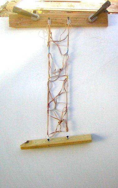

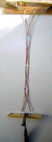

Can we find a simple model for a homogeneous material that exhibits necking?
Suppose we model a rod as chain of "identical" coiled springs connected end-to-end along the x-axis. Pulling on the ends of the rod (slowly) would cause the coils of the springs to form narrower coils, but there is no reason one spring would coil narrower than another.
Suppose we model a rod as a two parallel chains of such springs and connect each junction of two coils on chain A with a vertical spring from that junction to the corresponding junction of chain B. I see no reason why stretching the rod would pull the two x-axis chains of springs closer together near the middle (assuming there is no initial tension in the springs that go in the y-direction.)
Now suppose we join the two chains of springs that go in the x-direction using other springs that are not parallel to the y-axis. For example, we could join chains of springs A and B with springs that go from junction A[n] to B[n+1] and springs that go from junction A[n+1] to B[n]. If this configuration is stretched then do the two chains of springs in the x-direction remain parallel?
In tensile testing or pizza dough pulling, the very ends of the specimen are constrained so the specimen can't change its cross sectional area at its ends. To model that with chains of springs, we impose a similar constraint on the y-distance between the two x-axis chains of springs at their ends. Intuitively (to me) the force needed to keep the two springs apart that that constant y-distance increases as the rod is stretched. So the x-axis chains of springs won't remain parallel because if they did then, at their ends, they would not exert any force in the y-direction.

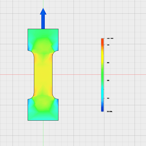

Finite element contour plot of von Mises stress in a flat dogbone tensile specimen pulled upward by an arrow, with a colour scale from blue (low) to red (high).
FEA showing VonMises stress in a flat test specimen under axial load .
It likely has to do with the specimens (pizza dough or metal test coupons) being gripped from the outside. The force being applied from the outside is transmitted as tension down the outer surface, and as shear towards the center.
There is some small deflection from the outer surface towards the center which could show as a dimple on a metal sample if the ends of a test coupon were polished to a mirror finish.
This longitudinal shear of the outer surface diminishes toward the mid point of any specimen. At the center the entire cross section will be in tension. At this cross section the first thinning is most likely to occur. Once thinning begins it quickly becomes the the path of least resistance. Effects like work hardening make the thinned section more broad.

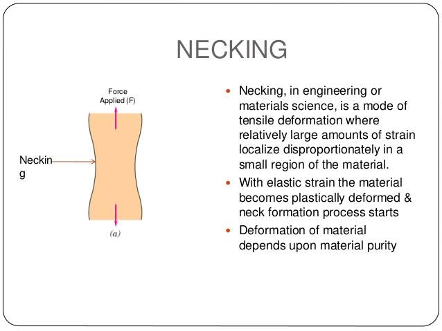

Here is a example of why necking happens. See if this help you out.
  • Slide titled NECKING showing a tensile bar with two opposing force arrows labelled Force Applied (F), the bar narrowing at its middle, with bullet points defining necking as localized plastic deformation.
