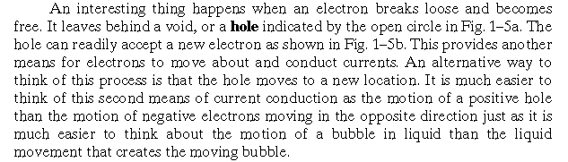

Holes are atoms in the silicon crystal lattice with one too few valence electrons. They are called 'acceptor' dopants.
When an electron attaches to an acceptor atom it leaves a hole wherever it moved from.
https://people.eecs.berkeley.edu/~hu/Chenming-Hu_ch1.pdf
That author uses a 'bubble in liquid' analogy
