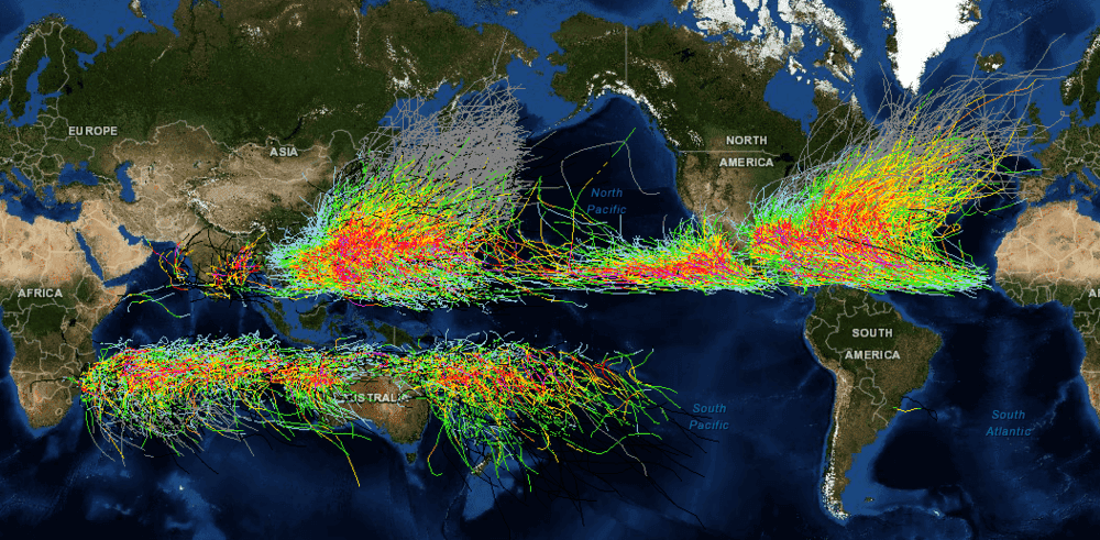

Not an answer to your question, but I just found this very beautiful graphic.
https://geozoneblog.files.wordpress.com/2014/05/globalwrappedclipped.png
World map of satellite-tracked tropical cyclone paths over the past decades, with colored tracks in the North and South Pacific, Atlantic and Indian Oceans, mostly curving poleward.
Note that there appears to be a single outlier that hit Brazil.

I just noticed that that remarkably straight line in your image is approximately level with the southern limit of the Sahara desert, which is also remarkably straight. I wonder whether there's a connection?
Also, lore is that cyclonic storms don't form near the equator (where the Coriolis force is zero), but every so often there is one, like Typhon Vamei in 2001.

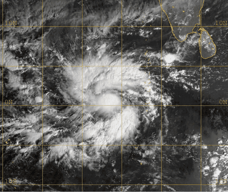

You seem to think a Hurricane is a point object. They are big. When they (rarely) form near the equator, they influence the weather on both sides. You can't just talk about the eye, because many storms don't have a well-formed or visible eye.
Here's Wikipedia's picture of Cyclone Agni. Can you spot the eye? And isn'tg it pretty clearly in both hemispheres?
Grayscale satellite image of a tropical cyclone over the Indian Ocean, with latitude lines labelled 10N, 0N and 10S and the coasts of southern India and Sri Lanka visible at upper right.
'You seem to think a Hurricane is a point object. '
Have you read the whole of this thread?
