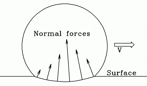

Even if the ball is rolling on a perfectly level and frictionless surface it will still come to a stop due to the forces of deformation at the contact patch. The ball deforms as it contacts the surface and the normal force which would be perfectly vertical becomes angled against the direction of motion and brings the ball to a stop. Actually, even on a non-friction free surface, these deformation forces are higher than the friction forces.

Are u saying objects slow down even in vacuum or are you just excluding a surface in my scenario because if it's the vacuum scenario that's very interesting
Yes, even in a vacuum there will be deformation at the contact patch and the normal force will be slightly redirected away from the vertical and against the direction of rolling. If the object is extremely hard it will deform only slightly and will roll a long time, but there will be some deformation and eventually it will come to a stop.
