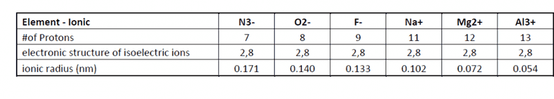

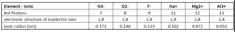

Generally, #p+ < #e- => electron-electron repulsion at the valence level => larger radius. In the isoelectric series, 7N(3-) > 8O(2-) > 9F(-) the #p+ the number of protons increase in series without changing the electron configurations. The increase in proton numbers functions to provide a stronger electrostatic attraction and reduces the ionic radius. The values given depend upon the analytical methods used which typically is related to measurement while the element is bonded in a structure. The exception is the Noble Gas radii which is based upon the Van der Waals radii. It is not sensible to compare radii of Noble Gas elements to radii of bonded elements. Neon radii are 0.154 - 0.160 nm depending on the source reference which is larger than the measured F(-) radii in a bonded system.
Trends in ionic radius for some more isoelectronic ions
