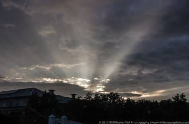

Do you mean this?
Crepuscular rays of sunlight fanning out through a dark, cloudy sky above a silhouetted rooftop and treeline at sunset or sunrise.
  • Crepuscular rays of sunlight fanning out through a dark, cloudy sky above a silhouetted rooftop and treeline at sunset or sunrise.

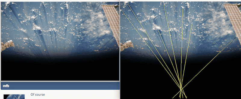

Keith_McClary said:
They should look parallel when viewed from space. Has this ever been photographed?
From directly above they would, but not at an angle.
Two side-by-side photos of Earth from orbit showing crepuscular sunbeams, the left unmarked and the right with yellow lines drawn along the light rays converging at a point below the image.
original and my attempt to doodle lines that follow the shadows​
  • Two side-by-side photos of Earth from orbit showing crepuscular sunbeams, the left unmarked and the right with yellow lines drawn along the light rays converging at a point below the image.
1. What sort of lens was used for that picture? Wide angle, no doubt.
2. The picture was taken from only 400miles above and the Earth's curvature could account for the apparent different angles of shadows. Remember all the hoohaah about the shadows in pictures taken on the Moon and the suggestions that they had to be faked? The effect of the appearance of shadows is not intuitive.
The lines you sketched would pass through the anti solar point which is 150Mkm away and not just to one side of Earth.
