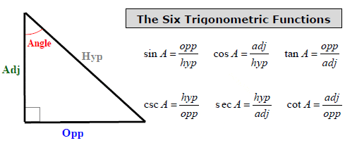

This is how the 6 trigonometric functions were originally defined:
Each if the three functions in the first row, sine, cosine, and tangent, has a complementary function defined on the second row, which function is just the multiplicative inverse; for example, cosecant A = 1 / sine A. Sine and cosine are ratios of the opposite and adjacent sides of the triangle with the hypotenuse, and yes, they are connected by the well-known identity sin2 A + cos2 A = 1. The exponential definition of the trig functions came many centuries after the geometrical definition, and the familiar trig identities are probably easier to derive using the geometry of the triangle than trying to manipulate an exponential, at least for teens taking trig for the first time.
Sometimes, most of the utility of defining similar functions is that each is convenient to use in certain situations.
