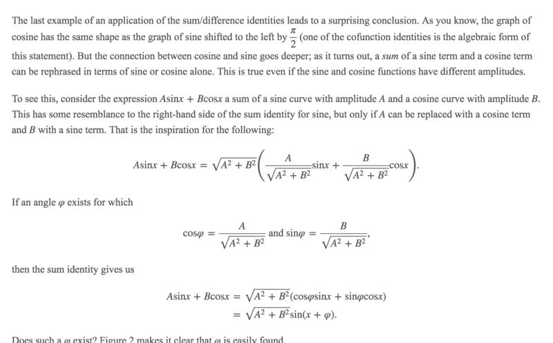

I have included a screenshot of a part of my textbook that is giving me a slight bit of confusion.
It's talking about how to get the formula for adding sines and cosines.
The part that I am confused about is the very first formula introduced in the screenshot.
From what I understand, we are taking one side of the sum of sines formula, and Asin(x)+Bcos(x).
The part in parentheses I do understand. It's stating the sum of sines formula in a different way. But I do not understand why the ##\sqrt{A^2+B^2}##, which would be the hypotenuse, is on the outside of the parentheses.

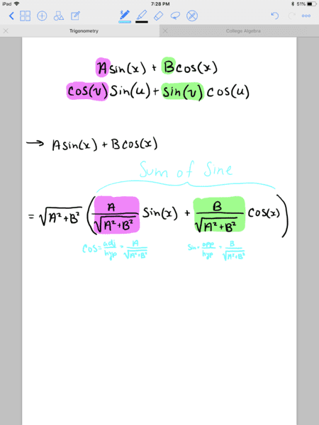

Here’s a shot of my understanding of it thus far.

In a thread earlier today, you learned that you could multiply one side of an equation by 1 and still maintain equality. So multiply ##A~sin(x) + B~cos(x)## by ##\frac {\sqrt{A^2+B^2}} {\sqrt{A^2+B^2}}## and see what you get. It should look a lot like the first line of the derivation.
AH! That's the one! Threw me off a little because it looks like they did that, and they factored the square root term out of the numerator and left it in the denominator. That is perfect, thank you!
