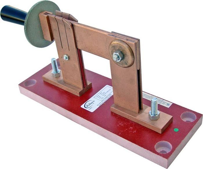

The answer is (a), except that most damage occurs when you try to open the switch and stop the current.

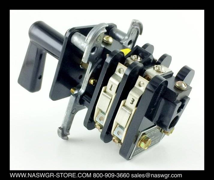

The picture below shows the type of ignition switch you would need on the dashboard if there was no solenoid.
Before the 1970s, relays had bad reputations in power plants and other process industries. Poor reliability of interposing relays was the problem. Because of that, the conservative engineers and operators preferred to eliminate the relays by directly switching the high power in the control room. SB-1 switches like the one in the picture were typical of what they used. As others in this thread mentioned, the wires to the switches had to be suitably thick.

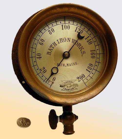

Similar thinking also led to distrust of boiler pressure gauges that depended on remote sensors. So they piped high pressure steam to the meters in the control room. However, if the meter's glass broke it would cook everyone in the room like lobsters.
