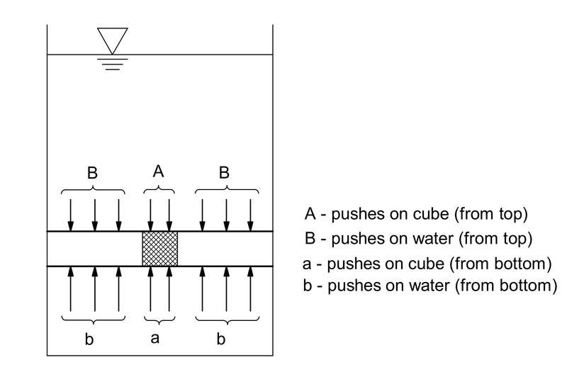

Only if the water above and below the cube is not "communicating" (e.g. in two separated compartments). The weight of the water above the cube acts around the cube on the water below the cube and increases the pressure. And why shouldn't it? Otherwise that would mean that the weight force of all the water above the cube is lying on the top of the cube.
Sorry but i didn't understand
@Pranav all that matters is the pressure. The pressure is determined by the depth of water above. The amount of water below does not matter. The pressure increases as you go down, therefore the bottom is always subjected to a greater pressure than the top.
Pranav said:
And more the pressure more you will be pushed down??
No, you are pushed in a direction normal to the surface. That is down on the top, up on the bottom, and inwards on the sides.
So the upwards force on the bottom is greater than the downwards force on the top. The net force is therefore upwards (buoyant)
