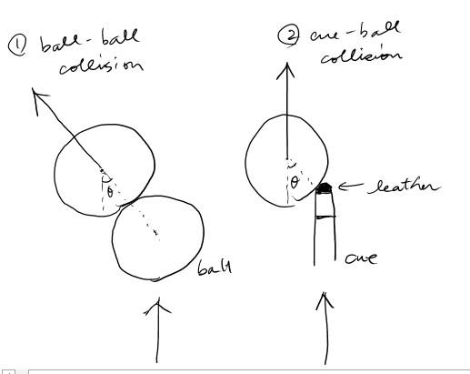

Isn't it necessary to consider the angular momentum in this situation, though? The forces involved are difficult to quantify - as with most collision problems - because they will vary throughout the ball - cue collision so it's best to think in terms of momentum and angular momentum changes and Impulses. That's ok, I think, as long as it can be assumed that angles don't change much during the actual collision. Flexing of the cue adds a complication but any flexing will only produce a significant change in the 'lateral forces' on the cue.
What I have found out is that a tangential impulse on a (free) body will produce the same change in angular momentum as linear momentum. So a sphere with all it mass at the centre and an MI of zero will not move forward at all if it's struck tangentially (simplest case). A dumbbell (MI = mr2, struck 'tangentially' will move off at half the speed as if both masses were together and struck with the same impulse. A solid sphere is half way between, with an MI of 2mr2/5 so the translational momentum due to a tangential impulse will be 2/5 of a single mass of m. That implies (to me) that the effect of the tangential component of the cue's impulse will only be 2/5 of the radial component. So the diagram that's been used, showing Ft and Fr, neglects this factor of 2/5. As far as I can see, this will mean that, for a collision in free space, the ball will always move slightly (or a lot) to the left of the cue direction. It needs the steering action of the balloon the cloth to make it actually go straight.

But this isn't just a case of 'applied forces' it is 'applied impulses' and the times involved will depend upon the MI of the object. I would agree that a string pulling the ball along for a while would produce a result other than what I am describing. Unlike with the string, once the cue has left the ball, it no longer has any effect on it. That involves another concept.
Imagine dropping a barbell, with one end held on a string. You would have a form of pendulum and the tension in the string would vary in time. That would be different from hitting one end of a barbell in space.

I am still having a problem with this.
Are you saying that an impulse applied radially for a brief period will have precisely the same initial effect as an impulse applied tangentially? How does that argument work for a dumbel? The time of the action is the same but the forces are different (being due to the reaction against the cue).
In addition to this basic idea, if there is any slippage between tip and ball, the tangential force will be even less less, which could also be relevant.
I can't be sure, from you remarks, whether you are just insisting on the application of Newton's laws (which is, of course right) or whether you are really appreciating the forces (impulses) involved. The dumbel model is simpler but easier to see.

Why do you have a problem with this? The resolved radial and tangential forces can be found from the applied force vector. They are different and they are applied for the same time. Is it not reasonable that their net effect can also be calculated? Additionally, if the tangential force is beyond limiting friction, the tangential effect will be even less.
Where is the hole in that argument? We are. after all, discussing the net effect on the ball and where it will go.

What is your opinion about the actual situation and whether this net force can be in line with the cue?
If a player is aware of a sideways force on the cue (and they tell us that the cue actually bends) then that suggests to me that the net force on the ball is to the left. Some other force is needed for the ball to end up going straight.
Rather than just pointing out that part of the above is "wrong", it could help if you could add something positive.

You don't like the term "weighting" but you must agree that the two forces will not be the same. They are both reactive forces. The radial force is due to the mass and the tangential force is due to the MI divided by the radius. They are different and that is what the weighting is about. It isn't necessary to calculate the actual value as the direction is all that counts.
I have scribbled some calculations which suggest that the value of tangential reactive force is 2/5 of the radial reactive force for a uniform sphere. I have to go out and chop some wood in the sun but I will try to present the sums in a readable form. Would you disagree with my earlier idea that a cue hitting a rigid sphere with all its mass concentrated at the centre would (could only) experience a zero tangential reaction force?

Sure, in the first video the friction would have to be about 1/4-1/3 of the normal force, in order to explain the result by impact alone. These aren't completely unrealistic friction coefficients.

You seem to be completely ignoring the relevance of Moment of Inertia. Can you disagree that it is crucial and that the ratio of forces is calculable? The effect of friction will be very non-linear in view of the cue tip material and the chalk so you can't do more than say it could reduce the tangential effect. The MI is always with us yet you still don't seem to be acknowledging it. Do you, in fact, get my point about a sphere with all its mass at the centre?

A single short impulse on an uniform resting sphere should result in the following relationship:
w/v = 5/2 * r/R2
where:
w : angular speed
v : speed
r : lever arm of the force around the center
R : radius of the sphere
In the below video a quick & dirty analysis yielded an error <10%. Thus the observed kinematics can be explained without significant forces other than the cue impact.

That's interesting and the 5/2 factor is familiar. But could you translate that into direction of motion? Remember, the force on the ball is not necessarily in the direction of the cue (or the cue wouldn't bend*.
What was your quick and dirty analysis? Looking at the linear and rotational motion between frames? That is not the complete kinematics of the situation.
* In fact, the net motion will be in the direction of the net force, which is patently not in the line of the cue. That's putting it in a nutshell.

Only if you know the direction of the force and that goes without saying. Can you help with calculating the actual direction of the force? You seem to imply that you could but I should do it myself. Can you do it?
As you said yourself, it's the direction of motion.
