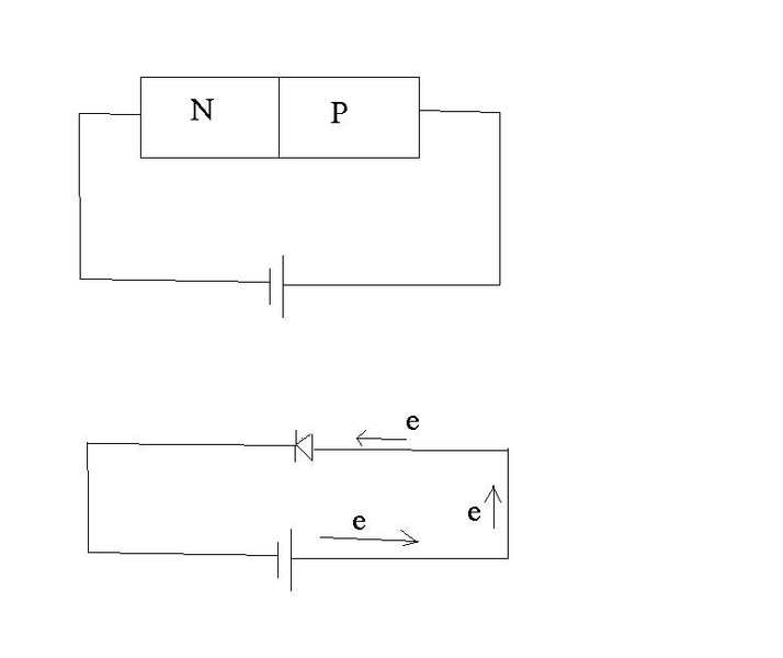

why diode has such a sign??
by the bottom sketch we have the diode to be short circuit
but if we look at the upper sketch we see that the current (ie electrons)
flows from the plus p side
for diode to be short circuit we ned to have the electrons flow to the n side
not to the p side
and i remmember my lessons of basics circuits
they said that the current flows from the big potential to the lower potential
so the electrons move from plus
so if its true the diode cannot be short circuit in that way?
Conventional current flows form positive to negative, current was invented before electrons.
The simple for a diode is supposed to look like a one-way arrow
so current is not the flow of electrons?
then what flows there?
Current is the flow of electric charge.
There are two things that confuse people:
1, electrons don't move (much). The electricity flows through a wire at almost the speed of light but electrons only drift a cm/s. The electricty is more like one electron bumping into the next and pushing it, it then pushes the next one and so on.
2, Current was invented before people knew about electrons and people arbitrarily decided it flowed from positive to negative. This is just a convention - like deciding that North is UP on a map.
Now we have discovered electrons are negative and actually flow from negative to positive there is a small problem. in practice this doesn't matter you can just ignore the electrons and use current, or imagine a negative current flowing from negative to positive.
In semiconductor physics we picture a flow of 'holes' which are imaginary positive electrons (or rather the absence of an electron) which do flow in the correct direction.
