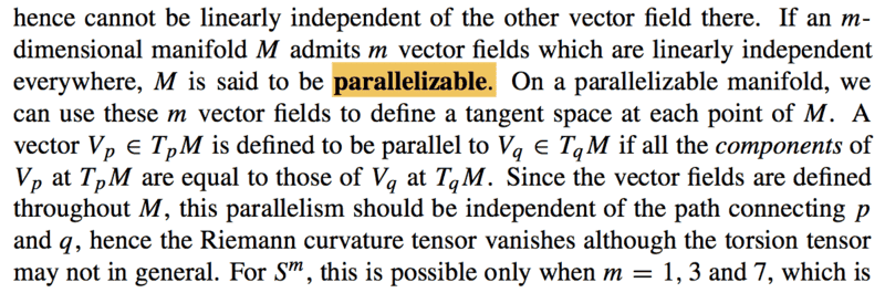

Thank you for your reply. However I am a bit confused. I attached the part of my book that I took this from (it is from Nakahara, Geometry Topology and Physics). As far as I understand, parallelizable manifold, implies zero Riemann tensor. Could you please explain this to me a bit further (i.e. what am I reading wrong)?

I will have to think about what the book is saying.
What I said is correct. I am assuming a Levi-Civita connection and your book is not. That has to be what is going on.
The key passage is:
A vector ##V_p \in T_pM## is defined to be parallel to ##V_q \in T_qM## if ...
This defines the connection and therefore the curvature tensor. There is no a priori reason why this connection should be the Levi-Civita connection or even a metric compatible connection.
Orodruin said:
The key passage is:
Oh, I misunderstood this. So by this they mean that by parallel transporting a vector between 2 points, you keep it having the same coordinates in the respective tangent planes. I thought that this is a general property of a parallelizable manifold (i.e. independent of connection). Thank you!
