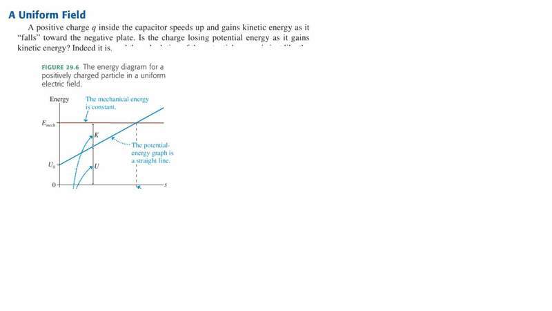

Look inside the paint doc.
My question is why does the paragraph say ...A positive charge q gains kinetic energy as it falls towards the negative plate...
However the graph shows that the positive charge q loses kinetic energy...
I am confused what am I not understanding?
"Falling" appears to mean going toward x = 0, i.e. going left in the graph.
I think the U and K labels are the wrong way round in the diagram if time is increasing to the right. K should be increasing and U should be decreasing if a charge starts at rest on one of the plates and accelerates to the other - which is what the written passage says.
