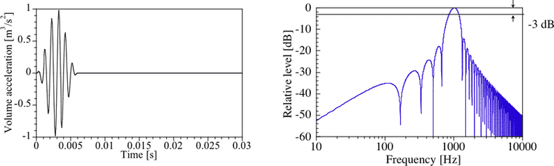

Elaborating on what @phinds said, here are the results of the Fourier spectrum for a burst of tone.
Two plots: left, volume acceleration in m/s^2 against time in seconds showing a short oscillatory burst near 0.002 to 0.005 s then zero; right, relative level in dB against log frequency in Hz showing a main peak near 1000 Hz with side lobes and a -3 dB reference line.

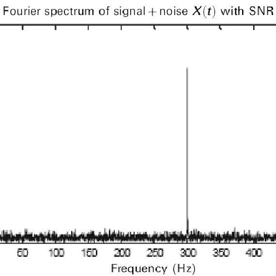

Whereas below are the Fourier spectrum of a pure tone (continuous, not burst)
Forget the numbers on the axes, just look at the shapes.
Fourier spectrum of signal plus noise X(t) with SNR, showing a single sharp peak near 300 Hz over a flat noisy baseline; x-axis labelled Frequency (Hz) from about 0 to 400+.

A pulse of pure tone is constructed in the time domain by multiplying a pure tone by a rectangular pulse or window.
A non-linear product, (multiplication), in the time domain, results in sum and difference frequencies in the frequency domain. That is how frequency mixers and modulators work to add and subtract frequency.
A rectangular pulse is made from a fundamental frequency, plus an infinite series of harmonics or overtones. It is those harmonics and their side-bands of pure tone, that you are hearing in the "pulse of pure tone".

Further to this comment, notice that the spectrum shown is plotted on a logarithmic frequency scale, which hides the fact that the signal has the same pattern of side frequencies above and below the tone. Actually, the lower side frequencies cannot extend below zero frequency and so are folded over and then increase. This creates a messy and non musical sound.

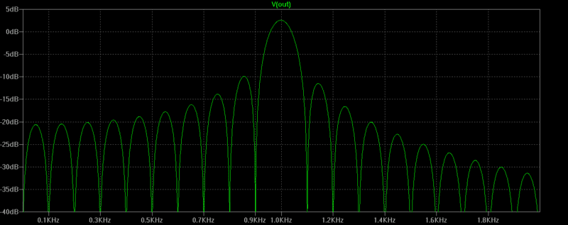

Here are 10 cycles of 1 kHz.
Simulator plot titled V(out) of a 10 ms burst of about ten sine cycles at 1 kHz, peaking near plus or minus 100 V, on a 0 V baseline between 435 ms and 465 ms.
The centre frequency is 1 kHz. The pulse lasts for 10 ms.
The reciprocal of 10 ms is 100 Hz, so there is a null every 100 Hz.
Simulator plot titled V(out) of a spectrum in dB against frequency from about 0.05 kHz to 1.9 kHz, showing a main lobe peaking near 1.0 kHz at about 3 dB with sidelobes falling off on both sides, nulls spaced evenly about 0.1 kHz apart.
