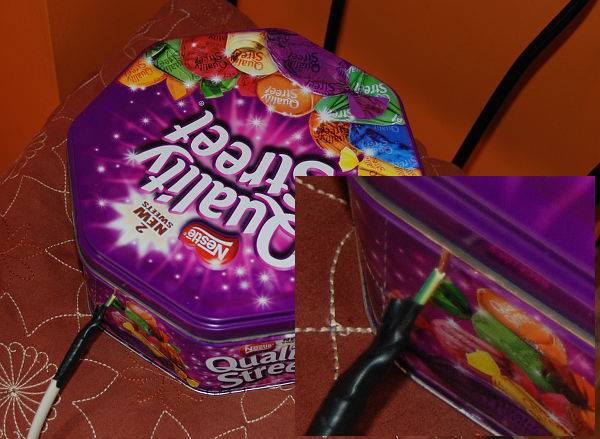

I've put a small battery powered commercial radio inside a Quality Street tin. The tin is all metal with rolled joints and the lid is a tight fit. I'd be willing to bet that there are no holes greater than 0.1mm around the lid's closure.
Why does the radio work when receiving an AM station (1 MHz), but only produces static when switched to FM (100 MHz)?
The depth to which RF can penetrate an ungrounded metal shield is frequency dependent. Read about skin effect/depth.
I don't know for sure what will happen, but try grounding the tin to a water pipe.
AM is around 1Mhz, FM is around 100Mhz. Skin depth will be 10 times less at 100Mhz.
Minimum signal strength required for AM and FM receivers also differ (FM has capture ratio)

If there is a narrow slot around the lid closure, this may allow the radio to work at MF. A ferrite rod antenna, as used in your receiver, can work when placed inside a metal container, such as a tube, having a longitudinal slot in it. It is sometimes said that the H-field of the wave can then enter, whereas the E- field cannot. The system is used for precision direction finders. However, the theory of how it works is subject to discussion, because in essence, E and H cannot exist separately. For the VHF case, if the slot is half a wavelength or more in length, the signal can enter. But in your case, the slot is perhaps 0.2m long, whereas half a wavelength is 1.5m. A slot can be extremely narrow, like a razor cut, and still work as an efficient antenna provided it is long enough.
The tin is electrically small at lower AM frequencies so you can mainly treat the fields (IRT to shielding) as quasi-static and separate on it if the loss from skin effect is low. The ability to shield electostatic fields from the outside is related to the conductivity of the metal and the ability of free charges in that conductor to move and neutralize the field inside in response to the external field. The ability to shield static magnetic fields depends on the permeability of the metal and its ability to shunt or draw the field away from the inside of the enclosure not to block the magnetic field. A ferrite rod antenna receives the magnetic field conponent of the EM wave so it should have little problem at AM wavelengths in an enclosure with likely poor permeability at that frequency range like a thin metal tin. Even tiny electrical gaps in good shields would allow some flux to enter the box.
Is my answer technically wrong? If one assumes a wire antenna (not a loop, or ferrite), would skin depth be the primary difference?
I didn't think of the ferrite vs whip antenna possibility, which is likely the major difference, but I'm curious beyond that.
Assuming a wire antenna, would grounding the box make any difference?
The slot eh? The tin is approximately 300mm in diameter so that slot might actually be 900mmish long.
I'll ground the box tomorrow and see...

With closure of the tin, it is not the width of the gap that counts but the length of the slot. A long slot can support a peripheral RF current that emulates a dipole. A slot should work better when the length is closer to half a wavelength. Therefore 100MHz FM should work better than 1MHz AM through a shorter slot. There is also a rule of thumb that says a slot with a length less than one tenth of a wavelength will not radiate significantly.
I have known signals between 100kHz and 1MHz to pass through the welded forward hull of an ice strengthened ship. There was no local VHF FM detectable inside the forward hull. Any VHF FM would have had to enter through the gaps around the bulkhead doors that we closed to quieten the RF environment.
So I think in your case it has to be skin effect and the sensitivity of the receiver employed that is making the frequency sensitive difference.

I looked up the skin depth for various metals at 1 MHz. For copper it is 65 um and for steel it is 7.5 um. If the material is 30 gauge, that is 305 um thick. Of course, the signal does not stop at the skin depth, but continues to fall off exponentially, so if the signal is very strong, reception might still be occurring. The receiver has Automatic Gain Control , so even a weak signal may sound quite normal.
Having just looked this up a couple of days ago, the skin depth is the depth which the currents degrade by 1 neper (about 8 and a half dB). A strong signal might be 60dB over the minimum needed. (Or considerably less; down to 0dB for a weak signal or a cheap radio.) It's surprising the radio works at 1 MHz, but not unheard of with a strong signal.
I've never seen a quality street tin. But from a picture there looks to be some sort of enamel or paint on it. The paint could act as a dielectric/insulator, or not depending on its unknown electrical characteristics.
BTW, Grounding to Earth and grounding to the receiver ground are different things.

Not really, I think the primary factor is the tin is just a bad shield at low frequencies.
http://hollandshielding.com/109-Mu copper Faraday cages
Does a magnet stick to your Quality Street Tin?
It probably will, tin plated steel is standard for these products. In the off chance that it is aluminum:
Skin depth of Al is 82um @ 1MHz. Food tins are typically 0.2mm thick or 2.4 skin depths, or 16dB attenuation (not much attenuation).

Paul,
Just curious how have you determined that the tin is acting as an effective Faraday cage.
Your original post said the radio worked when tuned to an AM station. I assume that this means that you could hear the programming, is this correct?. This would suggest it is not an effective Faraday cage, at least at 1MHz. If you are hearing AM through this tin then it is either entering through seams or through skin depth penetration.
Have you tried the magnet experiment?
