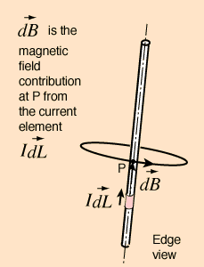

It is the magnetic field around the lightning bolt that is harming electronics. Its rapid rise induces voltages in current loops. Connected devices may have large loops, but also on a circuit board the induced voltages may be large enough to damage sensitive components.

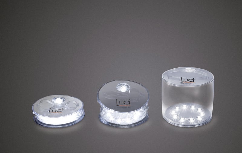

There is also something called a Luci light. It is an inflatable LED LIGHT/solar panel. When deflated, it stores in the size and shape of a short stack of DVD discs. I'll put one of those in a tin.

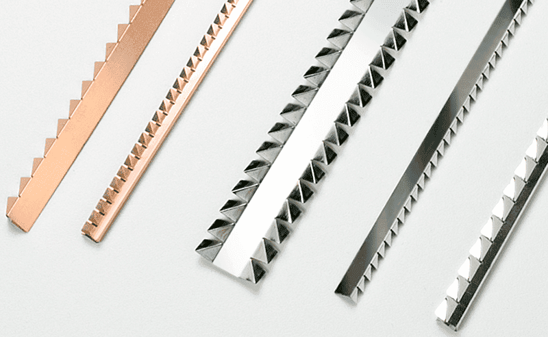

For sealing up seams (like between your tin and the lid), you should be using some sort of EMI gasketing material like spring fingers. To make a good conductive seal, you need 2 things:
-1- Many points of contact
-2- Air-tight contacts
You don't get that generally with conductive tape, so it's best to use spring-finger gasketing. There are lots of styles, but in your case you would want to use some that has pointy contacts that face both ways. You stick the strip to the tin near the top, and then when you put on the lid, it compresses the pointy things and makes multiple contacts around the circumference of the tin. Obviously the tin and lid need to be unpainted and uncoated in the area where the contacts are being made.
http://hollandshielding.com/content/2400/2400-Twisted-Fingerstrip-main-image.png

Imagine the rod below is a lightning bolt.
Ten kiloamps is only a medium-large one and lightning's rise time is in microseconds.
While your Faraday cage stops an E-field, i think it needs to be conductive enough so that substantial Lenz's Law currents can flow in it opposing the B-field that encircles the lightning bolt.
That'll reduce magnetic induction inside the cage.
So while your oven may not be a perfect Faraday enclosure i think it'll help provided its metal case is thick enough to allow a lot of current flow.
