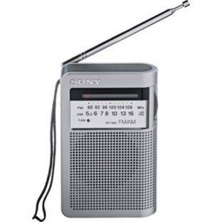

This is the radio. It's battery powered. I only use the Earth conductor as a ground, which is trapped under the lid. I cut off the live and neutral conductors.
Silver Sony portable AM/FM pocket radio with a telescoping antenna extended from the top, a dial showing FM and AM frequency scales, a speaker grille, and a neck strap.
I think you should try grounding the box to the ground terminal of the radio instead of the Earth ground. . Perhaps one lead of the headphone jack could be used as a ground terminal.

Radio waves are magnetic lines of force and will go through almost anything without loosing all their strength. Try putting a magnet close to the outside of the box then dangle a nail on a string inside the box. Move the string and nail closer to the magnet and the string will deflect, if moved close enough the nail will attach to the side of the box. The magnet's field is constant, but radio waves are moving and cut through the antenna and induce a small detectable currant in it. This is also how a generator or alternater work, a rotating (moving) magnetic field cuts through the windings of the stater causing currant flow.
Sun E Man said:
...ll go through almost anything without loosing all their strength.
How do you reconcile this thesis with the results of my experiment, whereby FM reception was totally blocked by the thin tin..?
It was not totally blocked.
The phase noise of the first LO in the cheap FM receiver was greater than it's sensitivity to the RF signal available inside the tin.
