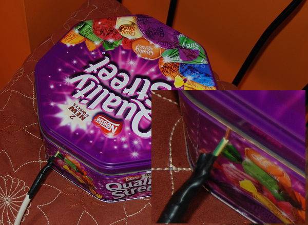

The magnet experiment, and some other actions suggested by contributors:-
The tin IS magnetic, attracting a magnet well
The walls are 0.25mm thick (including paint)
The inside of the tin is unpainted
This is the tin and radio (should have posted a photo earlier :frown: )
http://argos.scene7.com/is/image/Argos/5003820_R_Z002A_UC1051961?$TMB$&wid=312&hei=312
I grounded the tin to the Earth wire from a UK mains electrical socket, and repeated the reception test. I filed off the paint where the wire touched the tin. Results:-
FM: Total static. No discernible change with /without Earth wire. No Gaga.
AM: Tinny but recognisable radio station. No, repeat no discernible change in pitch or volume with /without Earth wire. Surprised.

This vexes me. Some contributors have suggested that the hiss is thermal noise in the early stages of the receiver. I take this to be stochastic Nyquist noise. If so, surely its amplification should also be random...
Doing the math:
0.25mm is 33 skin depths in steel which is 285dB attenuation. It's not getting in that way.
Seems like it must be a seal issue around the lid or bottom

To eliminate a possible entry around the lid you can try putting some copper tape around the lid seam.
Another possibility is the AM signal is not going through the tin, but is being re-radiated inside the box, with the tin box acting as a passive repeater. Nothing much you can do about that, I think.
Have you tried removing the AM antenna from the radio?
It's not so much it's being re-radiated. Even if the box had perfect E field shielding the H field would still not be totally excluded by absorption or reflection from skin-effect due to the low relative permeability and low cross-section of the metal at 1mhz. The actual loss might be much less than a typical skin-effect loss calculation. Usually the internal ferrite loop antenna (that's sensitive to the magnetic field component of the AM signal) is part of the frequency tuning circuit in a small AM radio so it can't be removed.
I don't really have any copper tape to hand for this unfortunately. And, the AM aerial is built into the radio so can't be removed.
I think that we have to conclude that I'll find it difficult to effectively screen an AM radio. I'll have to restrict my entropy source experiments to FM frequencies only. That should be all right. I can procure 1mm sheet copper so I can solder up a better box.

Tell us more about the wire that goes into the box.
The wire is shown in the picture you posted it looks like flat flex cable of 2 or 3 or 4 wires. Is it used for a speaker or power? it may be acting as an antenna and bringing signals into the box.

Shielding
The cable is a standard PC power lead with the computer connector end cut off. It's plugged into a power socket and I've bared and trapped the Earth conductor under the tin's lid. I filed off the paint on the side of the tin to ensure a good Earth contact. The Earth pin works in the power socket. There's no speaker cable, I can just hear the sound from the radio's in built speaker.
Do you power the radio with the power lead? If so this is what is carrying the signal into the box. Repeat the experiment with a battery powered radio.
