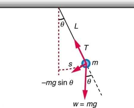

When a mass is in SHM, and is moving towards equilibrium point, its velocity starts to increase but why does acceleration decreases? What is the gradient when velocity is increasing and when it is at maximum? Thanks a lot!

I am only familiar with the displacement,velocity, and acceleration time graphs but I don't understand them quite well. The diagram attached shows the simple pendulum I am referring to
  • Free-body diagram of a simple pendulum of length L at angle θ from vertical, showing tension T along the string, weight w = mg downward, and the component -mg sin θ along the arc.

The velocity (actually the speed or the magnitude of velocity) decreases when the acceleration is negative. Nothing to do with the fact that the acceleration is increasing or decreasing. It could be constant negative acceleration and the velocity will decrease too.
The relation between velocity and acceleration is the same for any system: velocity is the first derivative of acceleration in respect to time. Positive acceleartion means that the velocity increases and negative acceleration means that velocity decreases.

In SHM when a mass moves towards equilibrium position, by definition it is restoring itself to a neutral position. Hence, at equilibrium position the force acting on it would be zero (since if it still had force acting on it, it would not be called a neutral or equilibrium position). But while coming back to the neutral position it gains a lot of momentum or velocity on account of force that is continuously accelerating it and therefore increasing the velocity till it maxes at equilibrium position since at this point the force acting is zero. And on account of Newton's 1st law of motion, it continues to swing to the other end.
