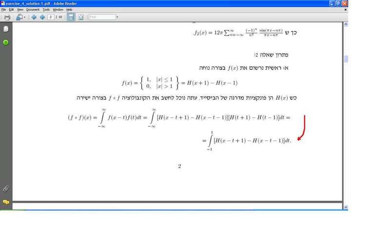

cant understand the red arrow transition
i changes the intervals and i cuts half of the arguent inside the integral
i can't see why
regarding the interval change
the H function is 1 in a certain interval
so if they change the integrval then its no longer H inside
because we have taken the '1' part of the H
regarding the cutting in half the argument inside the integral
i have no idea
The reason the integration limits change is because you're convolving two pulses that are only defined from -1 to +1, so the convolution is just 0 for all intervals other than -1 to +1.
