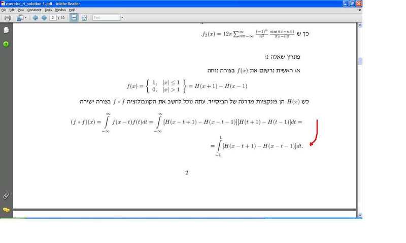

nhrock3
403
cant understand the red arrow transition
i changes the intervals and i cuts half of the arguent inside the integral
i can't see why
regarding the interval change
the H function is 1 in a certain interval
so if they change the integrval then its no longer H inside
because we have taken the '1' part of the H
regarding the cutting in half the argument inside the integral
i have no idea
On the interval 0 <= t <= 1, we have H(t+1) - H(t-1) = 1. Outside that interval, H(t+1) - H(t-1) = 0. The steps the author skips here are just simplifying steps. Can you get the rest from here? I hope this helps.
