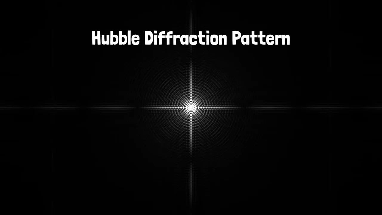

What I expected:
Grayscale simulated diffraction pattern on a black background: a bright central spot with concentric rings and faint cross-shaped spikes extending horizontally and vertically. Title reads Hubble Diffraction Pattern.
Image from MinutePhysics's video Why are Stars Star-Shaped?
So why is there a difference?

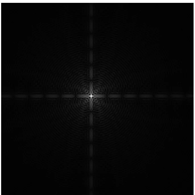

I tried it and I get this:
Dark grayscale image of a 2D Fourier transform: a bright central spot surrounded by concentric rings that fade outward, with faint bright lines along the horizontal and vertical axes.
Which does have the same general structure as what I'm aiming for, but doesn't "glow" as much

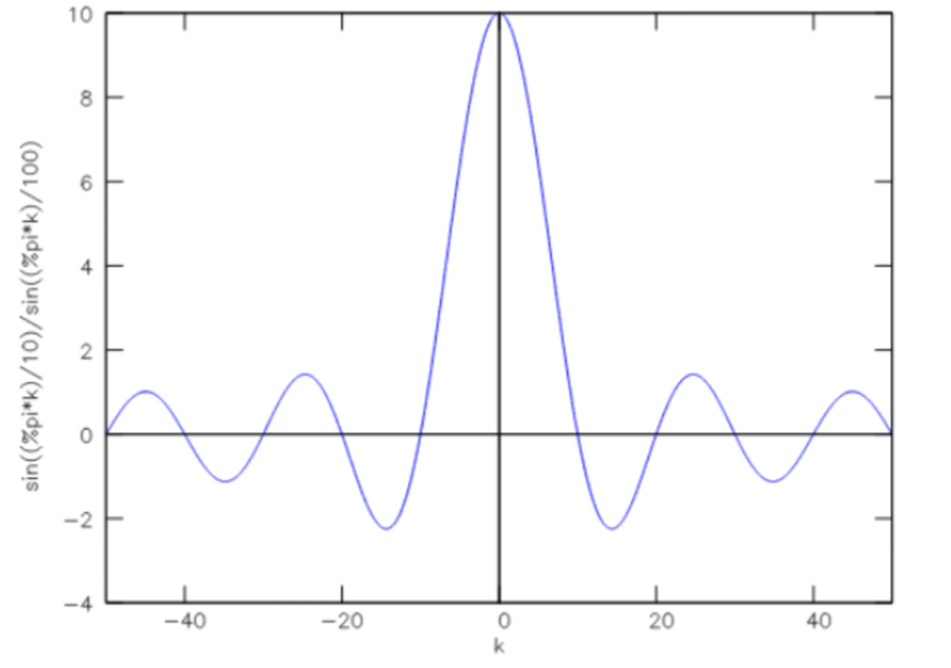

Let's do some maths. Under discrete FT, the 1d top hat function (##f(x)=1## for ##|x|<W/2##, 0 otherwise) transforms to $$F(k)=\frac{\sin(\pi W k/N)}{\sin(\pi k/N)}$$(Wikipedia) where ##N## is the number of pixels across your image and ##W## is the top hat function width in pixels. Eyeballing your image, you have ##W/N\approx 0.1##, so you would get this:
Line graph of sin((pi*k)/10)/sin((pi*k)/100) against k from -50 to 50, with a sharp central peak of 10 at k=0 and decaying side lobes oscillating about zero.

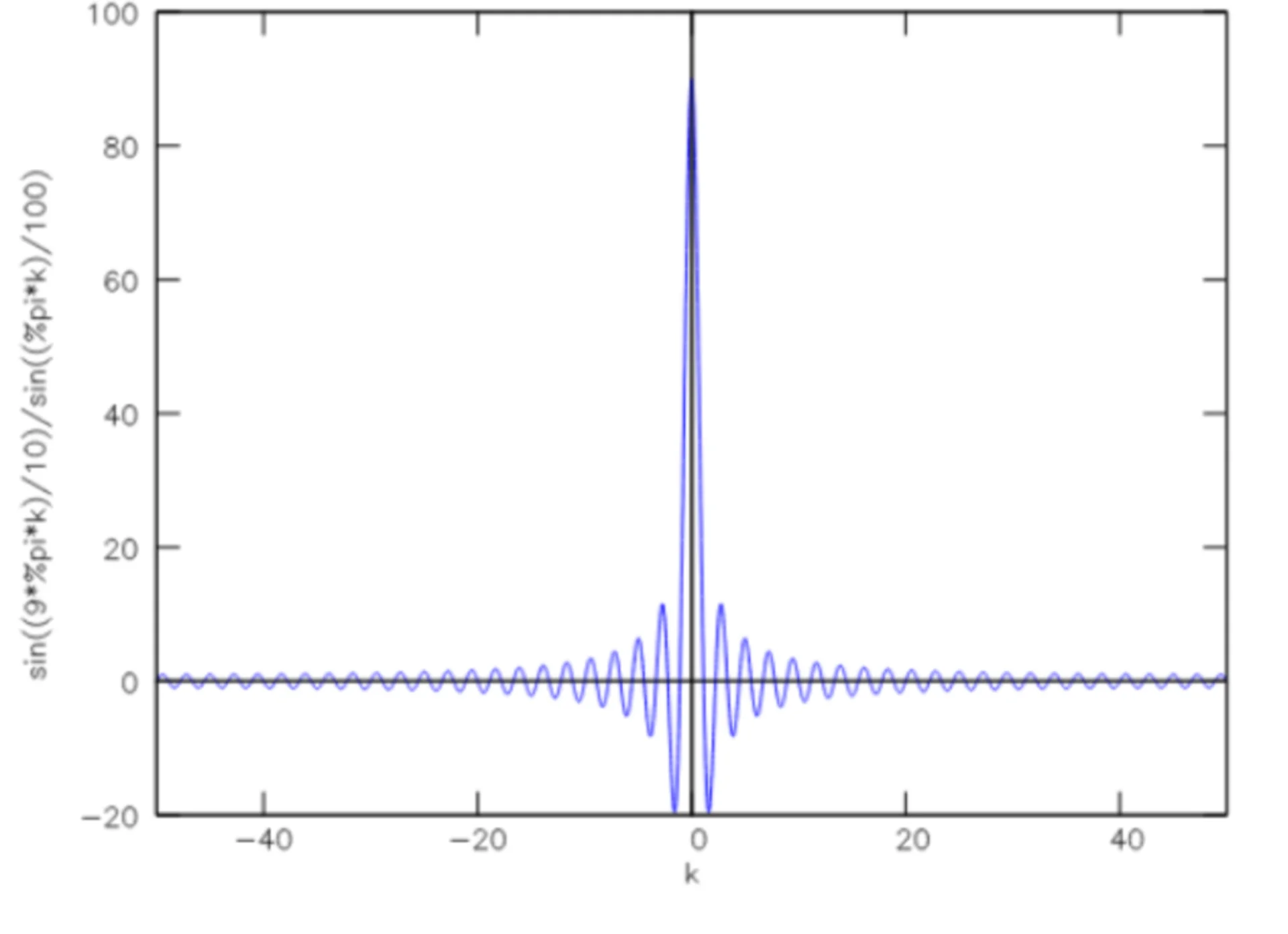

If you plug in ##W/N=0.9## you would get this:
Line graph of sin((9*%pi*k)/10)/sin((%pi*k)/100) against k from -50 to 50, showing a tall central peak near 90 at k=0 with decaying side lobes oscillating above and below zero.
The latter looks to me more like what you are expecting, so make your aperture much larger - play around with 50-90% of the width of your image. Up the number of pixels if you want more detail (FFTs work well with powers of two pixel counts - I think the library under python's DFT is FFTW which is more flexible, but ##2^n\times 2^n## is always a good choice).

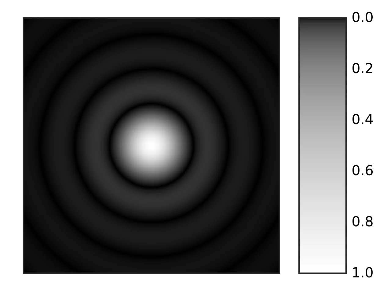

I think the issue is that, for reasons I am not smart enough to understand, the computed diffraction pattern is usually different to the actual diffraction pattern. Compare an airy disk that was computed with a computer:
Grayscale plot of a computed Airy-type diffraction pattern: a bright central disk surrounded by concentric rings that fade outward, with a colorbar from 0.0 (black) to 1.0 (white).

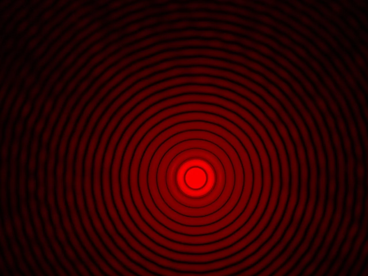

And one observed in real life:
Simulated concentric ring pattern in red on a black background, with a bright red central disk surrounded by dark rings of decreasing brightness outward.
The second-order maxima seem to be nearly as bright as the first-order maxima, while it is significantly less bright in the computed one
You should always cite your sources. That red image appears to be this one from Wikipedia. It's a laser shone through a pinhole.
Open that in a paint program and sample the colours of the middle two maxima. They're (255,0,0). That's why they appear the same brightness and that's why they aren't much brighter than the other maxima - because the camera saturated and didn't represent them correctly.
Take your generated image, find the brightest value in the second and third maxima, pick a value between those two values, and set your image to the lower of the image value and your chosen clip value. The result will probably look a lot more like the red image.
