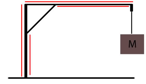

Im sure that all of the above is a lack understanding on my part. And so as a final request, can anyone recommend a book on vector physics? (i believe is the term) That is, I am interested in learning things like how changing the lengths marked in red of the following structure changes its state as to whether or not it collapses, and how removing things like the cross bar bit affects it.
What you're looking for is a book on engineering statics or vector mechanics (and strength of materials).
