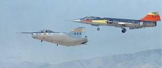

"Faster" depends on the frame of reference. Even a flat (non-curved) board moving forward at an angle of attack will generate lift. Link to an example article with a simple explanation of lift, and diagrams showing the movement of air affected by a wing:
http://www.avweb.com/news/airman/183261-1.html
Image of a pre-shuttle lifting body prototype (next to a F104 jet) that shows that the "longer distance" isn't always on top:

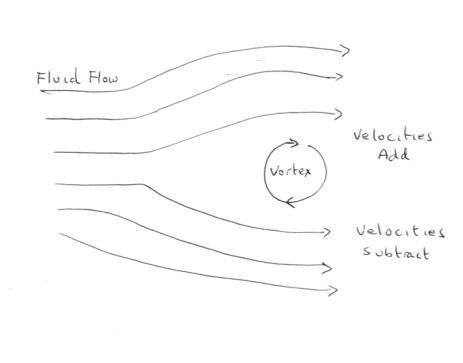

Read post 7... If conventional nomenclature had been used in the first place there may have been less confusion and your explanation would have received the credit it warranted?
I don't know why we have this seemingly perennial problem of wing theory.
The air over the top does indeed go faster than the air underneath.
This has nothing whatsoever to do with the distance it travels or the pressure difference over and under the wing.
Any half decent fluids textbook has experimental pictures to prove this and when I get time I will post some.
Bernoulli's theorem is not violated but pressure is a poor variable to compare because there is a huge variation of pressure from front to back both above and below the wing. There is no simple representative figure for the pressure above and the pressure below.
Here is a sketch to tie in Andrew's NASA explanation with my own. Yes indeed the boundary layer and vortex plays a vital part. I have not said otherwise.
I have not drawn a position for the vortex in relation to the wing because it varies with shape, speed and angle of attack.
However it does show how the vortex generates faster motion on one side than the other when placed in a fluid stream.
This is the only simple part of the theory and it is qualitative. To achieve useful numerical results one has to do some quite complicated maths probably by numerical modelling.
As I understand it, the vortices that enable lift are above the wing. That means that the air above the wing is moving at many different speeds relative to the wing and there is a layer next to the wing that is not moving at all. So I don't see how you can say that the air above the wind is flowing faster relative to the wing than the air below.
